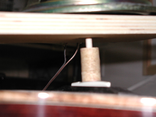

This has been something that I've been interested in for a long time now. I finally took a day off from the regular duties and made it happen. The design I came up with was 50% mine and 75% John Watkins' (Wait, that doesn't add up. Oh well, neither does much of anything else I work on).
the design has a probe connected to the voice coil. Probe in this case is 1/4" dowel which is connected to a cork. Cork in this case is actually a wine cork. I thought I'd introduce a bit of culture into the mix. The device is clamped to the neck at the nut with a hindge just below to allow the whole thing to pivot. The adjustment is at the other end of the neck via locking screws. I wanted the probe to make contact with the saddle but not too much weight so this allows me to back it off a bit if I need to.
I'll keep you posted on the extremely scientific results (aka my ears).

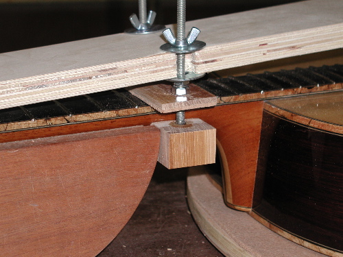

Beautiful guitar, Paul. I really like that spalted binding. Is the fretboard free-floating?   Adjustable?

PostPosted: Tue Nov 29, 2005 3:36 pm
Posts: 1584
Location: PA, United States
Hey Paul, I'm comin over tomorrow.
Wait, you live too far away. Nevermind
My setup is completely different. What MY goal is to make it sound like something it's not constructed to sound like. Breaking it in may not cover it.
It's kinda dark sounding, ok for fingerstyle. All I had was Corian for nut and saddle. Gonna switch to bone, and take of those D'Addario Alchemy lights and put on something brighter, and load the top a bit more. If that gives no hope, I'm selling her off pot haste. No time to experiment. Bills need to get paid yesterday.
I'll give you a holler Paul. Thanks for the post.
Thanks too Al, I like your scientific approach to luthiery too. This stuff will inspire many to come. Or is befuddle the right word
